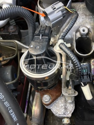

salam alikoum chabab, bghit nsewlkom ida andkom xi fekra ela had moxkil.. andi honda jazz model 2003 moteur 1.3idsi andi moxkil f vanne egr kitla3l code p0401 msa7to bzzf dial marat walakin kib9a 2j 3awed kirja3 bdlt dek egr b kmala w ba9i nefs moxkil kayen shi wahed y9dar yfedna?

khouya chouf wach le capteur li lié m3a l egr machi moussaakh

salam surfcaster, meerci pour la réponse,
wash t9dar t9oli ism dial had capteur wash kikon fost egr wla buahdo f circuit?

chouf le branchement li f had la photo hta houa khasso ytna9a w aussi les bougies

merci khoya surfcaster
les bougies 3ad bdltom men l9a wa9t gadi nshuf mea mecanicien y9leb circuit kamla shukran leek
