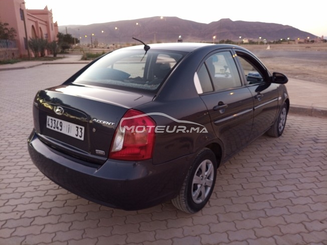

3ndi hyundai accent 2008 crdi o bghit ne3rf ina huile mzn l moteur et mercii

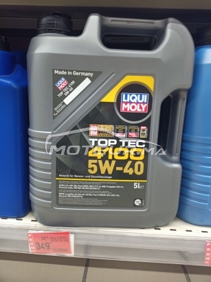

salam. previdange dir ricage moteur okayn likisamih flash engine dyal liqui moly kidir chi 80 dhs diro odemarrer 10 min apres dir vidange. ila lmoteur mazal na7la thala fih b zit maziana 5w40 matza9ramch. ana chrit hada men marjane . limohim howa lozoja oljawda o ma3ayir tkon tal3a. allahoma yassir

chokran khoya zidan 3la nassi7a dyalk
