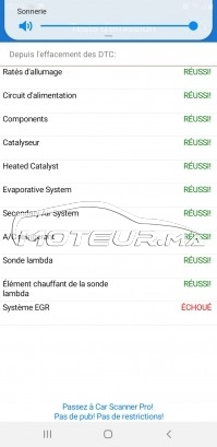

had photo fach knt drt diag kaiban lik system egren rouge dir diagnostique bach t2akad
