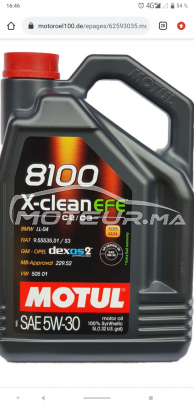

بعد بحث طويل. هدي هي الزيت ليقررت ندير.
fiha norme dyal Fiat lidayrin f laktab dyal tomobile
5w30 Fiat 9.55535-s1
hada kidal 3la anna zit mnasba l moteur dyali 100%. 7it Fiat dart liha test.
motul 5w30 x-clean 8100 efe

Chno ray dyalkom fhad la méthode.
https://www.motul.com/ma/fr/products/8100-x-clean-efe-5w30

Rah hadi hia zit li andir hta ana rah fiha Opel golina hir taman bach l9itiha khoya zidan

Mazal mamchit l marjane wla bricoma. f jumia l9itha b 500 dhs mais f sites internationales ta9riban 35 tal 40 euros. ila sawati goli bch7al l9tiha. limohim tkon original dir applicy scanner oscanner le code barre ochof wach ata3tik le produit .

Salam l ikhwa
had zit motul kanakhodha b 460dh mziana w mjarba w hia li kandir ma kanbedlhach

Choookran. 3la tafa3ol dyalkom . hadik zit motula akhay surfcaster andirha f a9rab forsa . andir vidange inchaalah 3la 7000 km n7ayd la9dima. ohaka kankon 3arf zit dyali omanbadalhach inchaalah. ila kan jadid anpartaji m3akom. o inchaalah makrahtch aghlabiya d nas idiro kima haka. bach nzido l9adam. kimagal si houssam. hadchi kifara7
