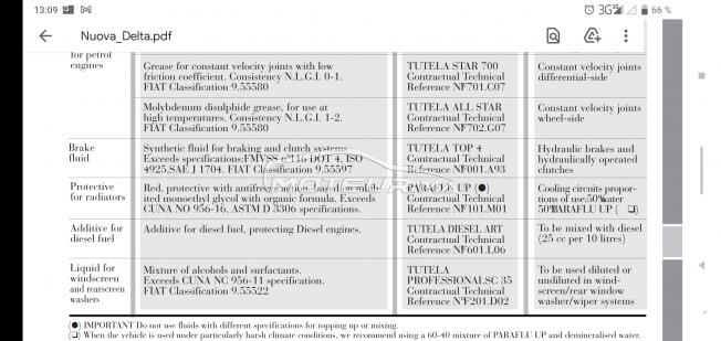

voilà les critères likaynin f notice dyal voiture et aussi zit likinas7o biha.

salam khot mchit l3and localub l station . ra7bo biya . l9it 3andhom zit b 505 dhs. ogaloli localub hiya lmowzi3 lwa7id orasmi f maghrib. dakchi 3andhom original. zit kidiwha s7ab taxiyat interval 20000 km . ya3ni 15000 nbadal zit. deuxième chose l9it 3andhom had antigel. ohowa lil9it f catalogue dyal tomobile. smito paraflu ..... ana nwarikom image o reference lif catalogue. chbalikom f had blan .
zidan
Zidan
منذ منذ 5 سنوات   629
notice
