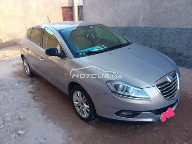

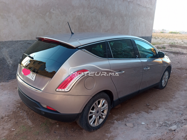

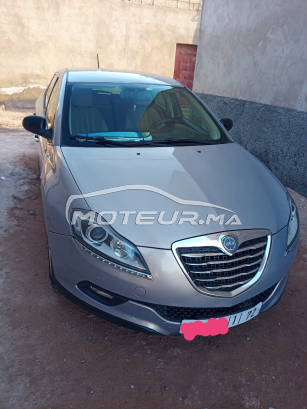

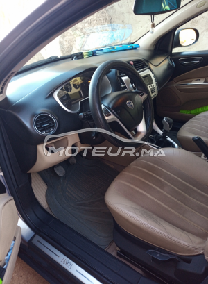

hhhhh. allah i7afdek khouya surfcaster. wallah had l9adiya dyal rinçage ana dartha 7it zit likan dorliha 7it molaha makanch fahem f zit daroliha 10w40 . badaltha odart rinçage l7amdollah wallah ila maziana kat7as b tomibil en pleine forme. walilah l7amd. o ta les filtres kamlin tbadlo ozit la boite ..... lbare7 dart liha ghasla b pistolet à pompe dyal katakhdam b allume cigare. o dart vaseline l tableau de bord sara7a . l7amdollah. anchof npartajo l3akom tsawer ila bghaw ijiw. consommation daba had sba7 drabt biha 25 km 4%

voilà

voilà

voilà

chkon f7alha mdawcha b bain douche hhh wallah
